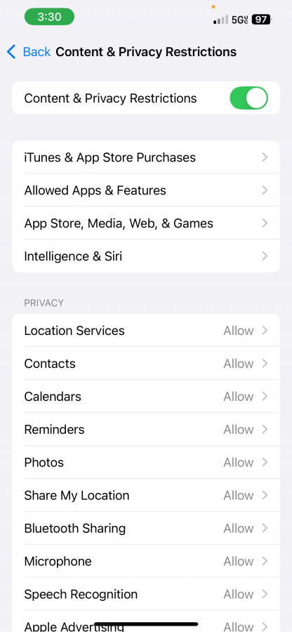

    With the latest iOS 18.5 iPhone update, the Carplay permissions might be disabled by default. If that affects your iPhone and you cannot connect to CarPlay via VLine VL2 or VLite VT2 system anymore, go to Settings -> Screen Time -> Privacy and Content restrictions -> Enable

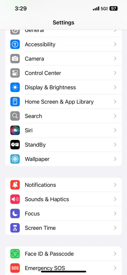

    1. Go to Settings
Name:	Photo Aug 18 2025, 3 29 48 PM.png

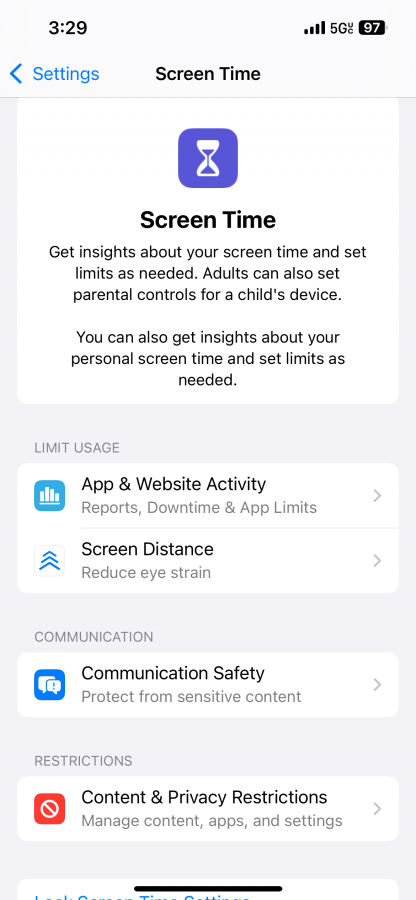

    2. Go to Screen Time
Name:	Photo Aug 18 2025, 3 29 55 PM.png

      3. Go to Privacy and Content Restrictions
Name:	Photo Aug 18 2025, 3 30 07 PM.png

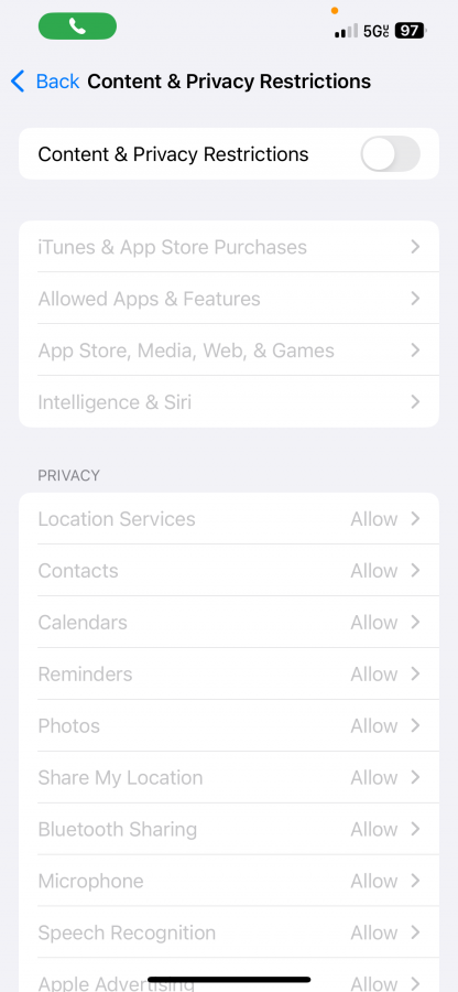

      4. Enable permissions
Name:	Photo Aug 18 2025, 3 30 16 PM.png
