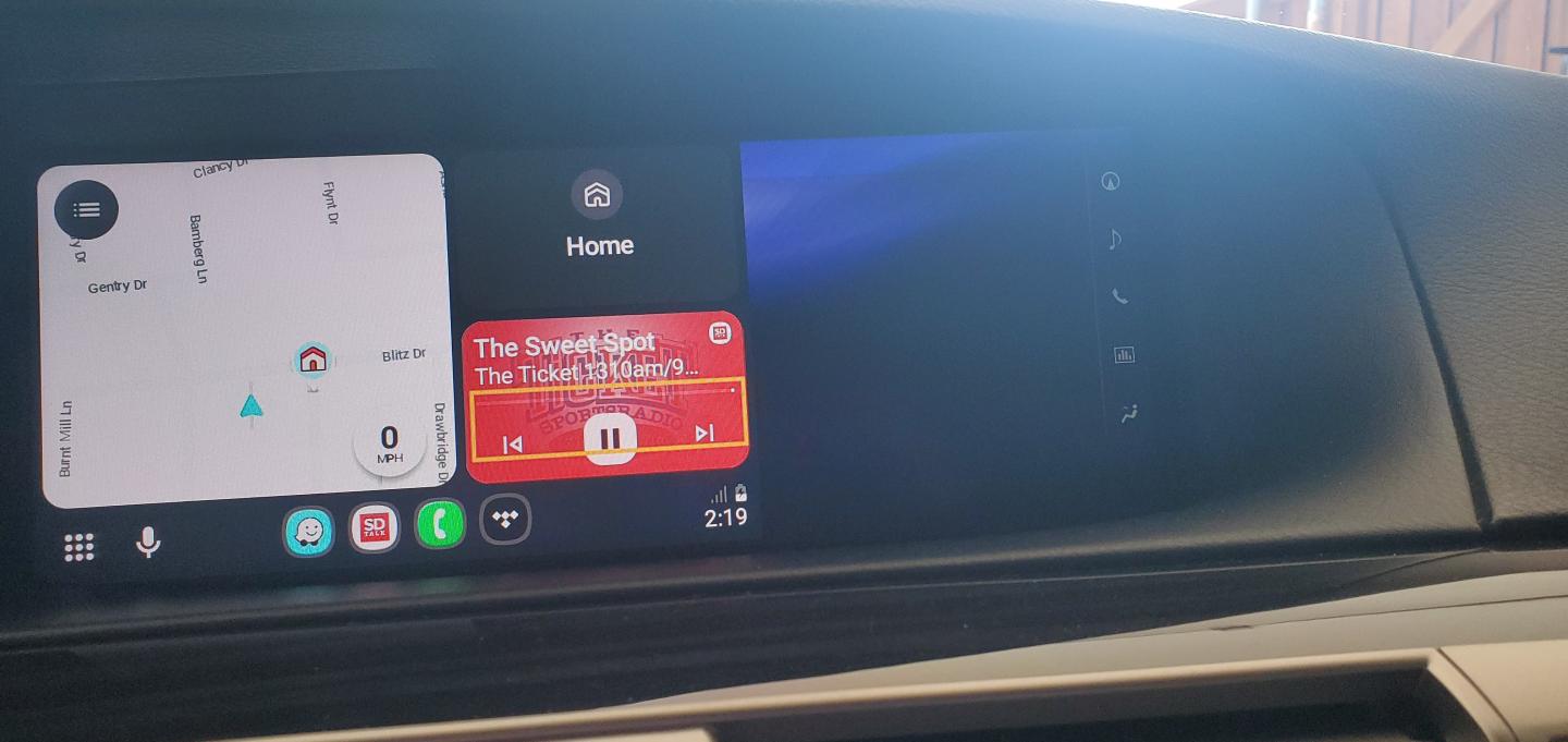

      Any updates on this, did the update on a 2016 LS460 before reading this post and now having the same issue. Mouse disabled, if I hold the menu keyp I get a mess on screen. No audio.
        Just in case anyone else runs into this issue it appears that the problem was that somehow my update appeared to be for a non-navi unit, hence the loss of split screen and possibly the loss of functionality of the mouse? Regardless of what happened during the update, through instructions from support I was able to load the previous version on a usb stick and install and all appears to have returned to normal.
        2016 Lexus LS460
