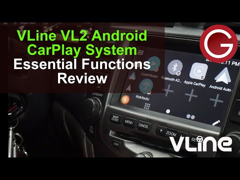

Watch our video, we go over the VLine VL2 basic functions, such as:
How to access the Support App
The Support App provides links to various essential functions of VLine, including Wi-Fi, Updates, CarPlay, and Android Auto connection tips and guidelines. It also has information about your device's serial number and installed software version.
Android Settings for the VLine's Android OS
You can change the time and language, check and apply updates, connect to Wi-Fi, reset, and reboot the device from Android OS settings.
VLine UI specific settings
Here, you can adjust the screen settings for display offset, brightness, and touchscreen calibration, where applicable. You can adjust the microphone gain, select preferred units, and change the user interface to the right-hand drive.
How to use gray "PLUS" signs
The gray plus sign can access apps, shortcuts, and plugins.
