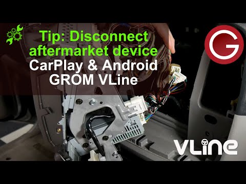

    When installing the GROM VLine VL2 / VLite VT2 system for CarPlay and Android Auto in your vehicle, it is essential to disconnect any aftermarket devices that were previously connected to your factory car stereo. If the aftermarket device is left attached, it can create a conflict or prevent the VLine VL2 / VLite VT2 system from operating correctly in the vehicle.
    Here is how we disconnect the aftermarket AUX car kit that was previously connected to the Lexus LX470 2004-2007 stereo:
