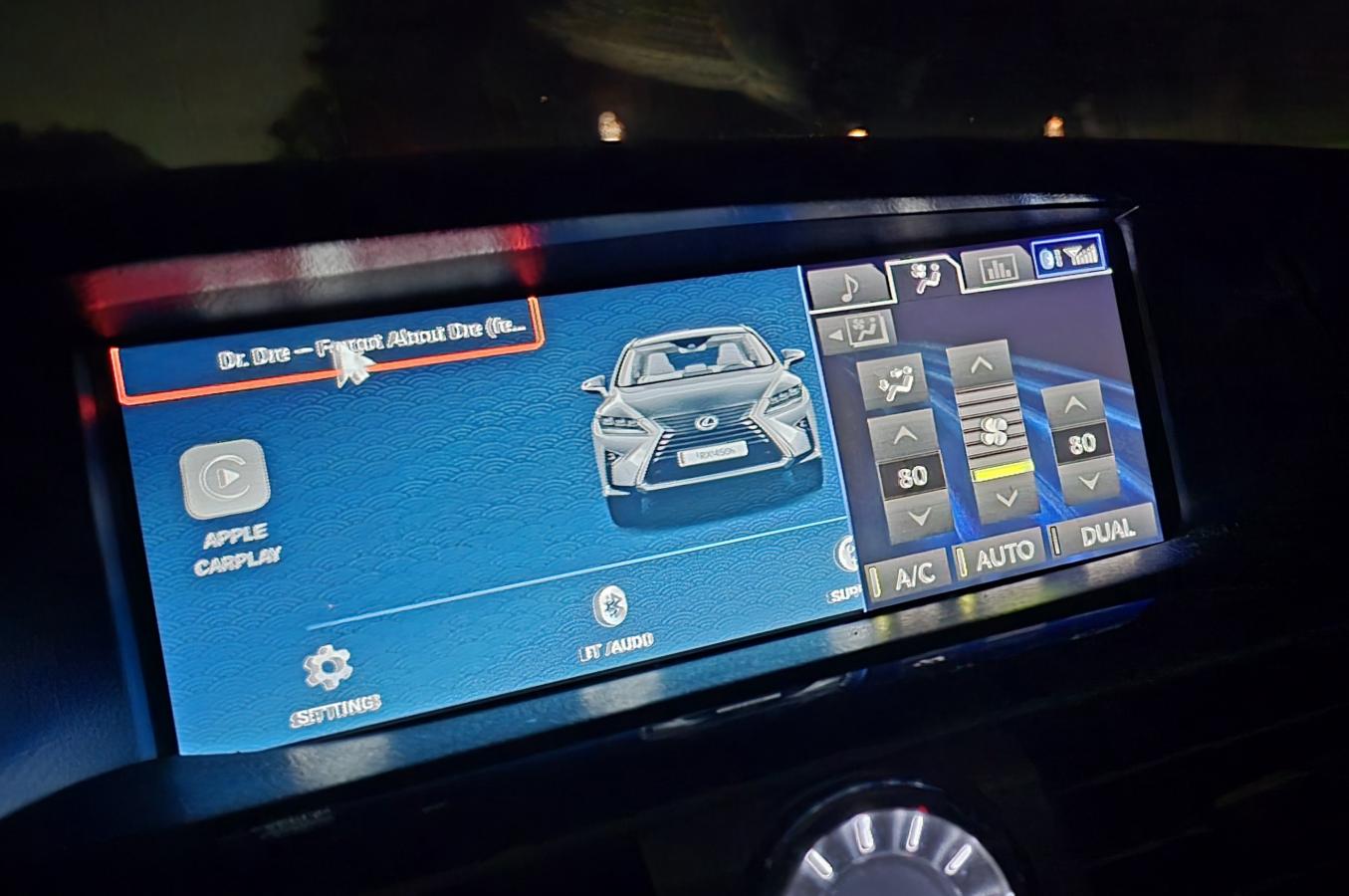

VLITE home screen Too large and doesn't display images on far right of screen
  • VLITE home screen Too large and doesn't display images on far right of screen
    In my 2014 lexus ls460 the Home VLITE screen display too large as is if out of rresolution doesn't show whole screen. In AA map screen doesn't show split screen when Display changed to Navigation closest to driver. I've changed DPI continuously. Can't see all menu items on far right of any screen especially settings. Please helps thanks

    Update everything ALL good now. Figured out that both the unit and firmware needed updates. I didn't realize that I needed to connect VLITE to my wifi through using my mobile Hotspot. It was difficult to log in with only being able to see half the screen, but I changed my Hotspot password to characters I could see and logged in. Then I was able to update the system and it was fixed.
    The update is great and allows the joy stick to recognize nearly every option on the screens and stop on them which makes selecting soooo much easier then hovering.
      Thank you for the update!
