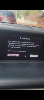

I am having an issue with my Android 12 upgrade. The system is now stuck on a screen where it wants to download the update, but it never does and just stays at 0%. the only option i have is to go to wifi and select wifi and click download but it never downloads and now my Head unit is unusable.

Sorry to hear this is happening! Have you tried different WiFi sources to confirm this is not related to the WiFi network you are using?
If you open the WiFi option from this Download Screen, you should be able to connect the VLine to a different WiFi source.

In this case, most likely we will need to send you a MicroSD card to reinstall the software fully and allow you to update once again.
Please contact us here so we can confirm the shipping address for the MicroSD card:
