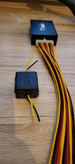

OK, I received a 20-pin ATX extension and a fuse/filter box. Could you please show me where 12V and GND are on the Grom USB3 port so I don't cause a short circuit? Perhaps it's better to do it via PM, because otherwise anyone could do it.
The wiring harness does not seem to be available in the UK
