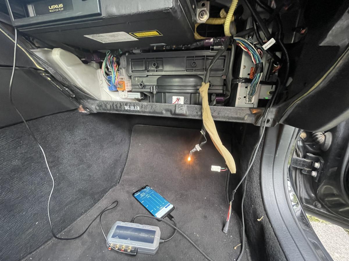

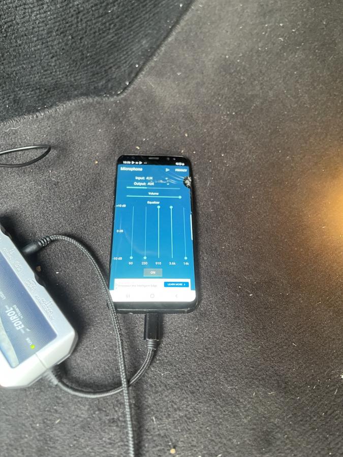

              The update:
              Another test later I am pretty sure standard microphone input has an upper frequency limit of about 500 Hz.
              I have tried supplying it with microphone signal band of 1-4 kHz (this way voice sounds like an Airplane "Your captain Speaking" which is unnatural, but very clear and keep most of the car noise out), but it seems like VLite completely ignores that band, and that makes no sense, since those exact frequencies are responsible for voice clarity. And everything below 500 Hz is where engine sound, all the other nasty noises are.
              Is it a software or hardware limitation? If software- can mic post-processing be disabled?
              Thanks
