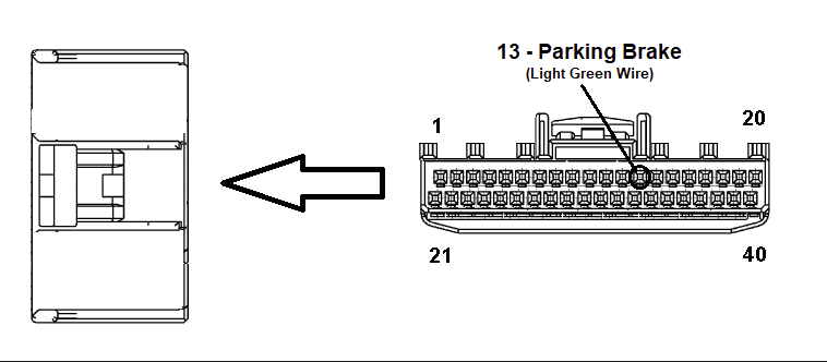

    The VLine VL2 / VLite VT2 uses the AUX source of the stereos in the abovementioned cars, which some radios support as an AV input source. In those cases, the active parking brake will not allow the VLine to display. If you'd like to disable the parking brake's influence over the display, please cut the light green wire on the 40-pin MCFNIS8 harness (PIN 13).
    Please refer to the diagram below.
