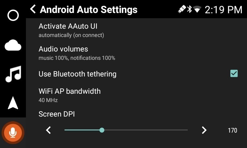

    I have the Vlite.. The interface is completely broken now that the Google navigation is on the left-hand side. Need an update ASAP - Acura TL.

    You can either decrease or increase the Android Auto screen DPI. It should help you get two apps on the screen and move the icons to the bottom.
    To do that, exit Android Auto and go back to GROM. In the Android Auto plugin settings of VLite, you should see the DPI settings. Increase or decrease them slightly, and give it a try!

      Where is the setting to move the nav back down to the bottom?
        In the Android Auto settings described above. Exit the Android Auto back to VLite and you will land in the Android Auto settings. There you can adjust the DPI and it will bring the buttons on the bottom.
