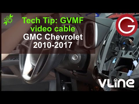

      Glad you were able to figure it out. We made the video specifically for this:
      The GVMF video cable plugs into the back of the display (not the stereo), need to pay attention to it.
