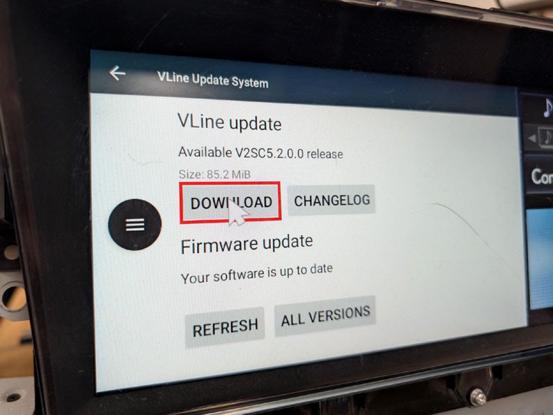

    To update, first connect your VLine VL2 system to Wi-Fi.
    Then go to Settings --> System --> VLine System Update
    Watch the video that explains how to perform a VLine firmware update:
