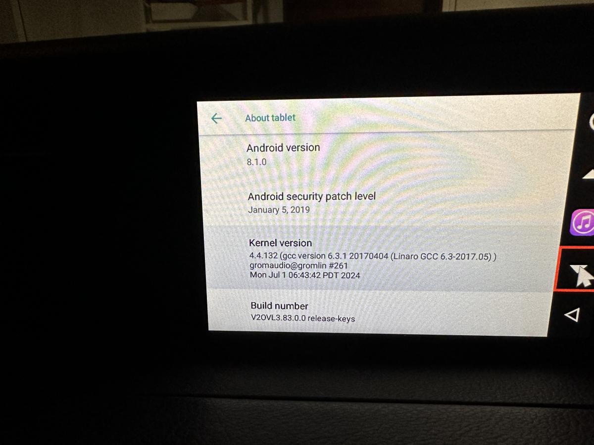

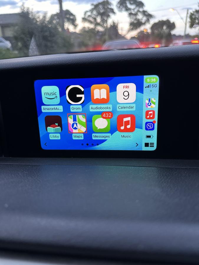

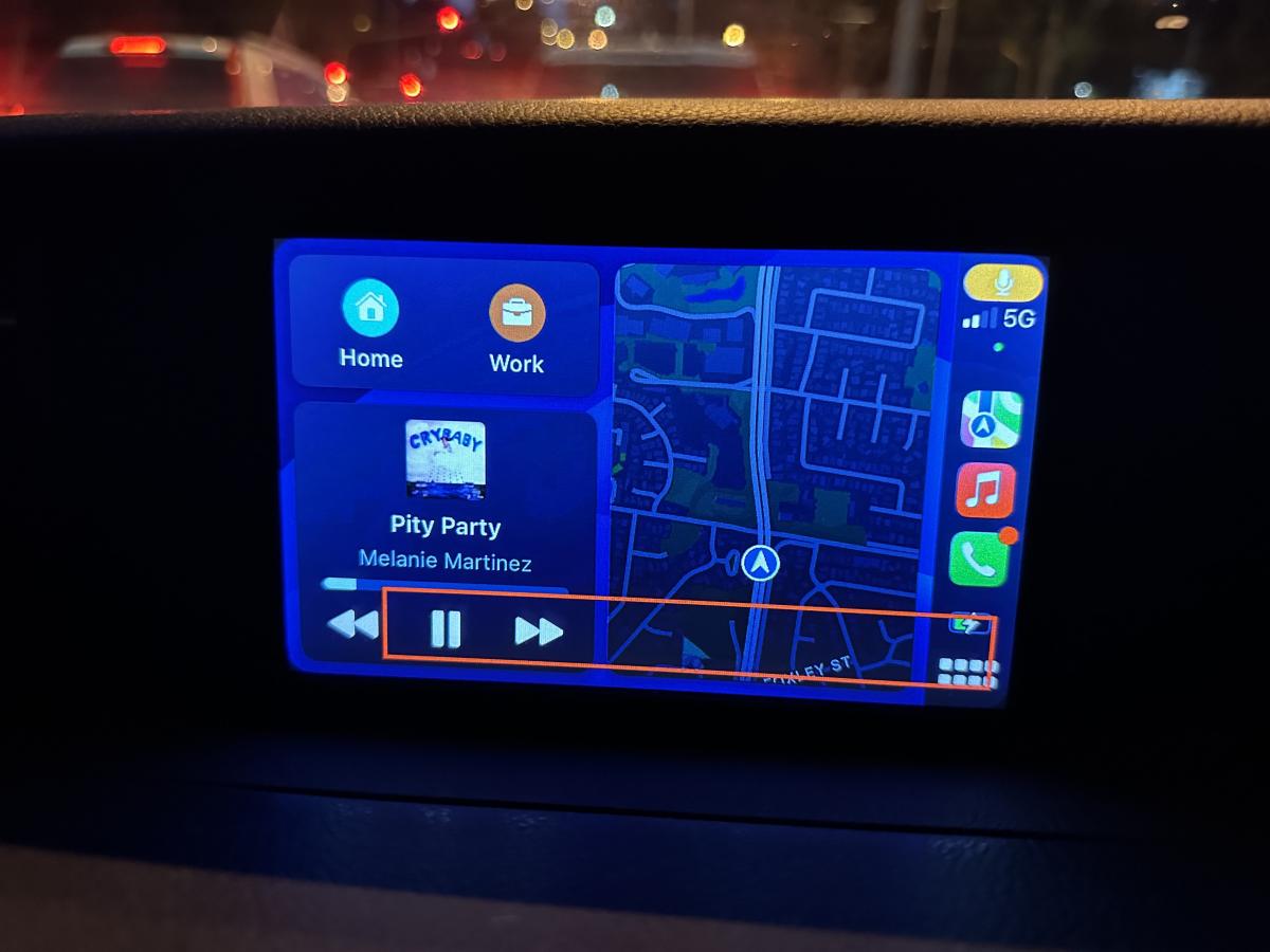

    I’ve bee using LEX89VL2 in my Lexus IS200t with the mouse for almost two years without any issues. I got the latest update a few months ago and since then is red box around most icons. It doesn’t interfere with anything except for the music selection as the box is quite large so I can’t click on skip or pause music. Couldn’t see anything that might have changed my settings.
    Has anyone else seen this issue?

    It is called haptic feedback. Looks like there is a glitch in the left-handed layout. We will look further into it.
    Please note that you can change the color from red to any other of your liking in the VLine VL2 settings. To do that exit the CarPlay into the VLine VL2 UI and select the "sandwich" menu at the top left corner of the screen.
      Ok, so a restart of VLine seems to have fixed it. I did see the red lines appear after another restart so I did another restart go back to get rid of it. May be it’s appearing on every other restart. Let me know if you need me to confirm it or provide other details.
