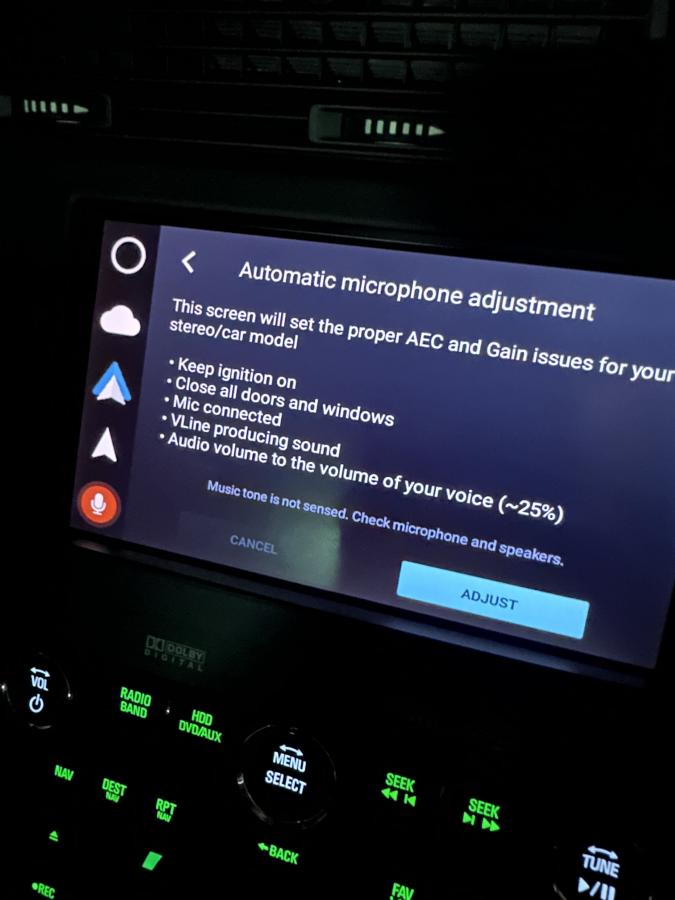

      I tried to do the „auto“ calibration as shown in the video but it gives me the following message after one peep:
      „music tone is not sensed“
      do I need to turn the volume up even louder than it already is? Click image for larger version

        Hello Christofson,
        The "Automatic Microphone Adjustment" might not always work well at 25% depending on multiple variables in the vehicle, including cabin size/volume and audio system configurations. Normally I would suggest putting the volume around 25% and slowly working up to 50% if it's not being sensed. If the signal is still not being sensed via the "Automatic Microphone Adjustment" at 50%, there might be an issue with the microphone itself.
        Can you contact us via Ticket so we can follow up with you? We might need to send you a replacement microphone or look into retaining your OEM Saab Microphone.
