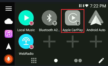

1. From the VLine VL2 main UI, go to CarPlay.

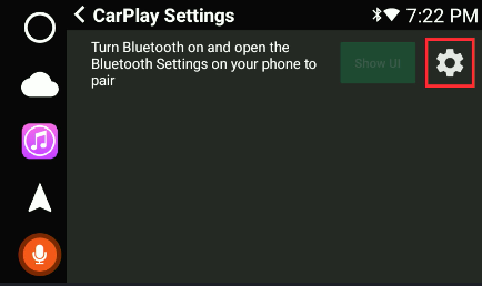

2. Go to Settings.

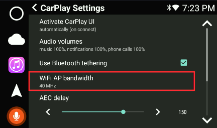

3. Go to WiFi AP bandwidth.

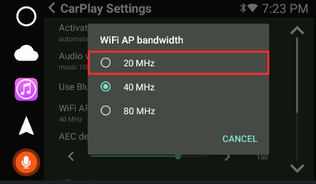

We default the CarPlay Wi-Fi AP bandwidth to 40MHz. However, some users reported that CarPlay would not work or experience interference on certain portions of their commute, and after changing to 20MHz, the issue was resolved.
If you happen to experience similar issues, please try changing the bandwidth to 20MHz.
2. Go to Settings.
