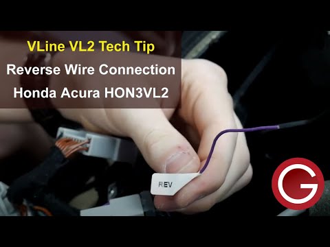

For installation into Honda and Acura vehicles, always connect the REV wire with the supplied P-Tap, according to our installation guide. Even if your reverse camera keeps working after the installation of the VLine VL2 / VLite VT2 system. you still need to connect the REV wire and ensure it is properly and securely connected at the correct location. Without connecting the REV wire the system will not work in your Acura or Honda vehicle.
Here is the video that explains how to connect and test the REV wire when installing the HON3VL2 / HON3VT2 system:
Note this video is specific to the HON3 models of VLine VL2 / VLite VT2. If you have HON2, HON2M, HON2V model of VLine VL2 / VLite VT2 - refer to the reverse wire insert that came with your installation manual, for the location of the reverse wire in your vehicle. Refer to this video for P-Tap connection and testing how-to.
