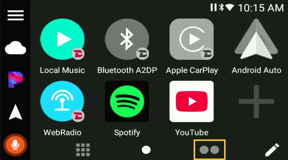

    1. On the VLine main UI screen, tap on the two dots at the bottom to get to the second page of the VLine UI.

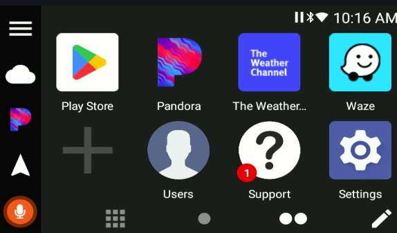

    VLine VL2 System User Interface
    2. Go to Settings.

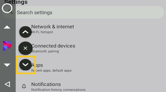

    3. Tap on the black circle with the three lines on the left. The floating navigation arrows will appear.
    VLine navigation arrows overlay

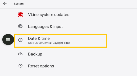

    4. Scroll down to System --> Date and Time
    System Settings VLine

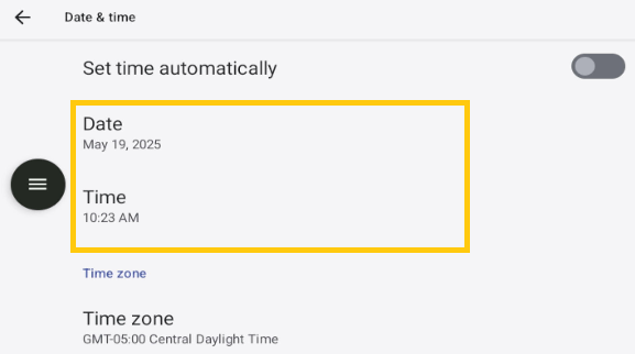

    5. Set the correct Date and Time for your VLine device.
    Date and Time VLine Settings
