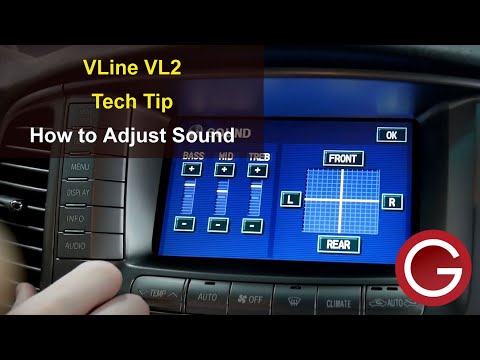

Hi there, I am having the same issue on my Lexus IS 250 2011 just installed. noticeable drop in sound quality compared to Radio/Aux etc. I am on the latest firmware etc, tried a restart and nothing seems to fix the quality issues. Is anyone else still getting these problems?
Have you adjusted the stereo sound settings for the VLine mode? If not, you need to use the Factory UI shortcut to get to the factory UI for the stereo mode that VLine took over. Then you can adjust bass, treble, eq settings for the VLine / VLite stereo mode. Here is how to:Originally posted by cammac92 View PostHi there, I am having the same issue on my Lexus IS 250 2011 just installed. noticeable drop in sound quality compared to Radio/Aux etc. I am on the latest firmware etc, tried a restart and nothing seems to fix the quality issues. Is anyone else still getting these problems?
If that will not help, contact our technical team at https://gromaudio.com/support.html
