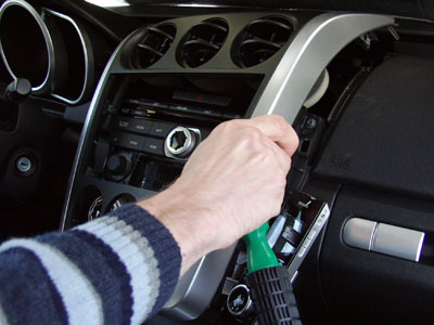

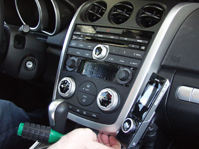

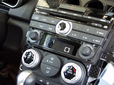

  2. Remove small black plastic car stereo insert
  3. gently remove the whole piece of stereo trim.

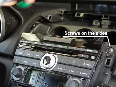

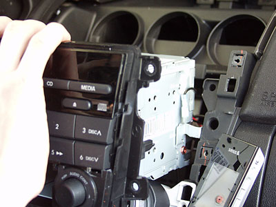

  4. There are 4 strews on the sides of the stereo (4 on each side). Unscrew all.
  5. Gently pull the stereo out.

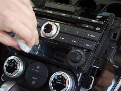

  6. Take the MAZ02 connector that comes with your GROM or Car2PC adapter
  7. Connect it to the CD changer port located at the back of the stereo.

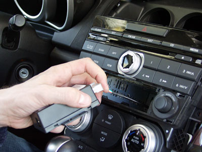

  8. Guide the MAZ02 cable to the middle of console
  9. Connect the other side of MAZ02 cable to the GROM black box or Car2PC black box

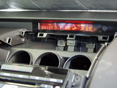

  10. Test the interface to make sure that everything works as it should. Press the CD button and you will see Disk EX 1 on the stereo.

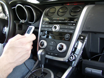

  11. Connect the iPod cable to the GROM black box, connect it to the iPod and test the music files.

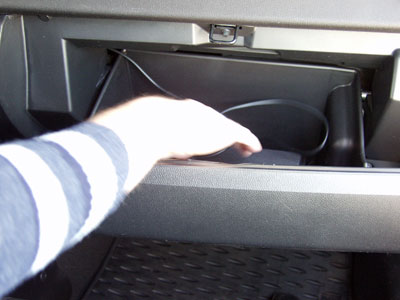

  12. Now when you are sure that everything works guide the iPod cable to the glove box through the hole between glove box and car stereo.
  13. You can also choose to guide the iPod cable differently.

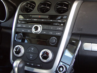

  14. Repeat the steps 5-2 backward to complete the installation.
