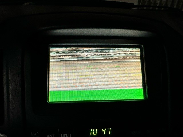

    1) Backup camera does not work anymore via the Yellow RCA Cable. It does enable but the video feed looks like it is it tearing.
    Click image for larger version  Name:	image0.jpeg Views:	0 Size:	49.8 KB ID:	1186

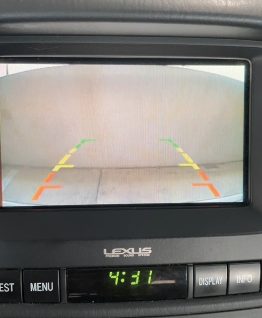

    How it used to look below:
    Click image for larger version  Name:	image0 (1).jpeg Views:	3 Size:	54.1 KB ID:	1187

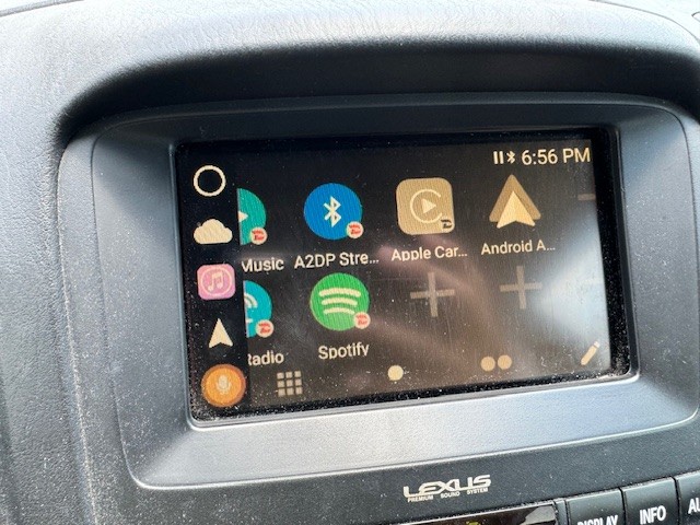

    3) Small issue - Side bar that has the back button does not stay put in the settings and sometimes disappears on the main app screen when it boots up.

            2) Navigation side bar is "Kinda" fixed. On boot it appears fine, but when Carplay is enabled and you go back to the GROM app/homescreen (from the Carplay screen) it disappears.
              Updated to V2SC 4.5.0
              1) Backup camera issue still persists
              2) Navigation side bar still disappears/cuts off
