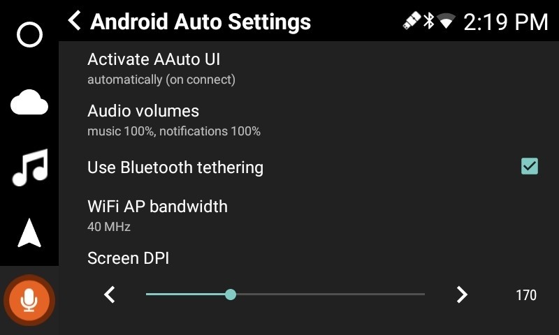

    Hello,
    You can either decrease or increase the Android Auto screen DPI. It should help you get two apps on the screen and move the icons to the bottom.
    To do that, exit Android Auto back to GROM. In the Android Auto plugin settings of VLine, you should see the DPI settings. Increase or decrease them slightly, and give it a try!
