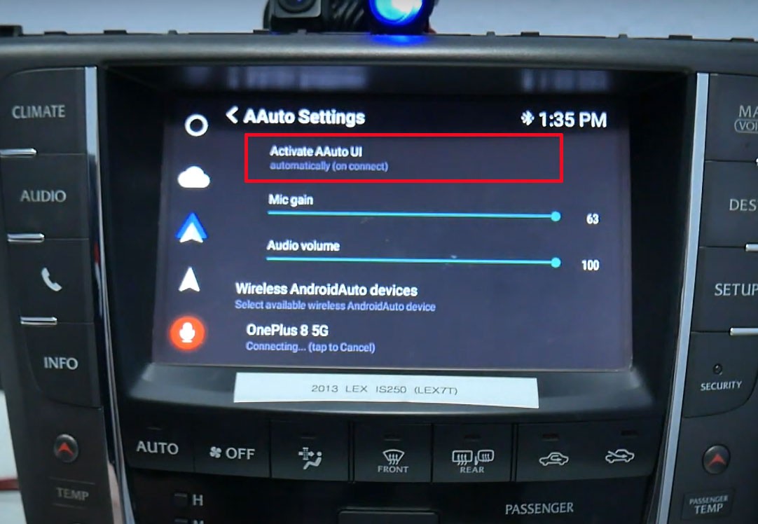

      As for "the top option" in step #3, once you are in CarPlay or Android Auto settings, at the very top there is an option that says "Activate Android Auto UI" or "Activate CarPlay UI" automatically (on connect). If you tap on it will switch to manually and you will have to connect manually every time you enter the car. See illustration.
