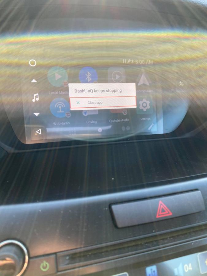

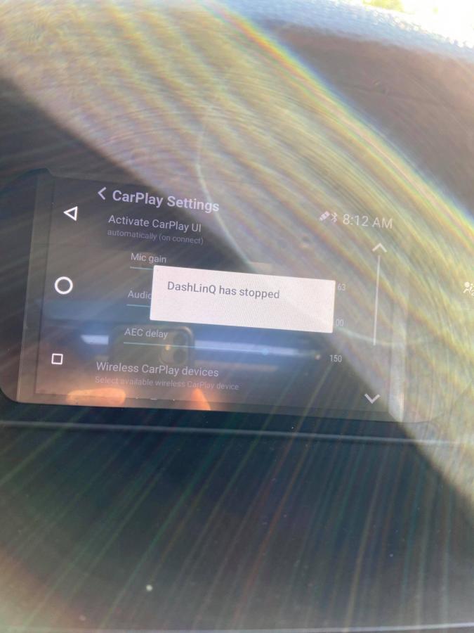

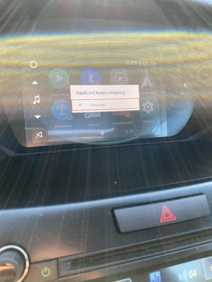

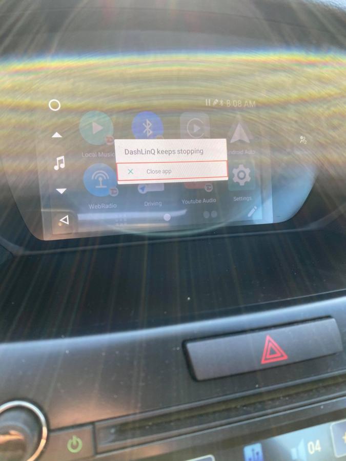

        Newest update did not help it. It happens once in a while. Dashlinq crashed and restart itself. Sometimes knobhelper crashed and I have no way to control the unit. Also, everytime I restart the unit in the setting menu I got it as well.
