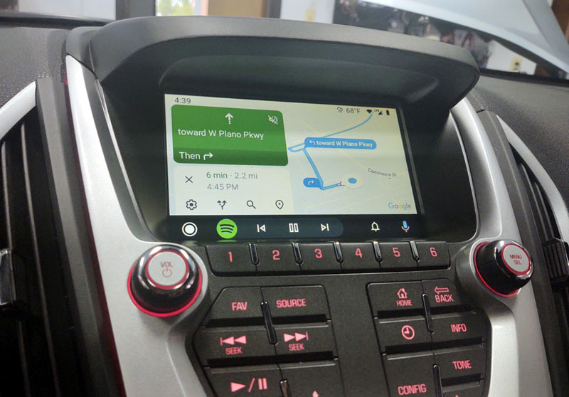

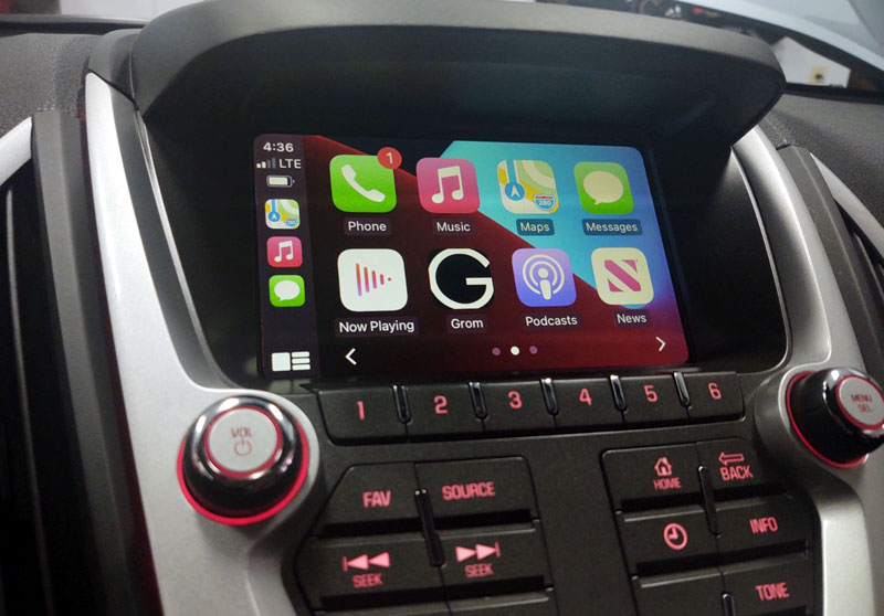

CarPlay on GMC Chevrolet Buick Mylink/IntelliLink 7/8-inch screen with GROM VLine VL2
CarPlay Maps on GMC Chevrolet Buick Mylink/IntelliLink 7/8-inch screen with GROM VLine VL2
