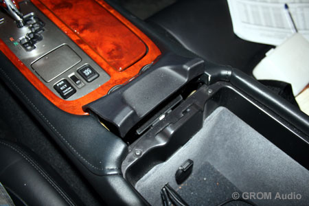

  4. Unclip seat heater switch panel.
  5. Installation of GROM USB MP3 and iPod  adapter into Lexus SC430 2006 - remove the radio
  6. Unclip trim around gear shift. Carefully remove button for radio door.
  7. Installation of GROM USB MP3 and iPod  adapter into Lexus SC430 2006 - unclip trim around gear shift

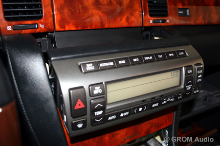

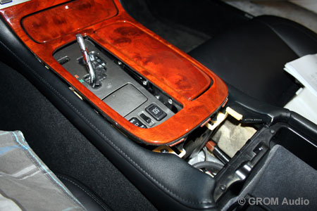

  8. Unclip AC controls.
  9. Installation of GROM USB MP3 and iPod  adapter into Lexus SC430 2006 - unclip AC controls

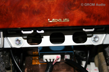

  10. Remove two 10mm bolts below radio.
  11. Installation of GROM USB MP3 and iPod  adapter into Lexus SC430 2006 - remove 2 10mm bolts

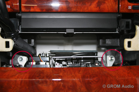

  12. Unscrew two 10mm bolts behind AC controls.
  13. Installation of GROM USB MP3 and iPod  adapter into Lexus SC430 2006 - unscrew two bolts behind AC controls

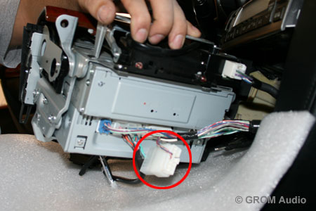

  14. Carefully take the stereo out.
  15. Installation of GROM USB MP3 and iPod  adapter into Lexus SC430 2006 - take the stereo out

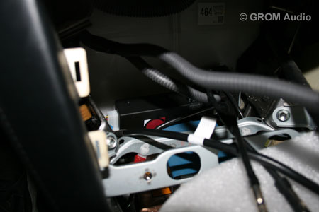

  16. Find the appropriate connector and connect TOY1 harness to it. Note: with Lexus SC 400 2006 sometimes TOY harness is used as it was the year when Toyota changed the compatibility.
  17. Installation of GROM USB MP3 and iPod  adapter into Lexus SC430 2006 - find the connector

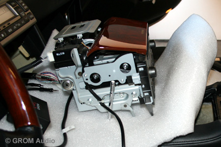

  18. You can place the adapter behind the stereo or route the cables to the glove box. For better accessibility we recommend using glove box.
  19. Installation of GROM USB MP3 and iPod  adapter into Lexus SC430 2006 - place GROM behind the stereo or in teh glove box

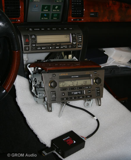

  20. Test the operation before assembling the stereo back. Hit DISC button twice. The stereo display should show DISC 1 TRACK 1.
  21. Installation of GROM USB MP3 and iPod  adapter into Lexus SC430 2006 - test the operation before you assemble the stereo back
